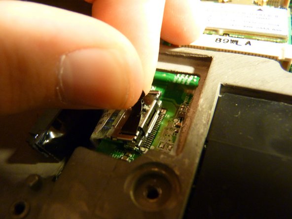

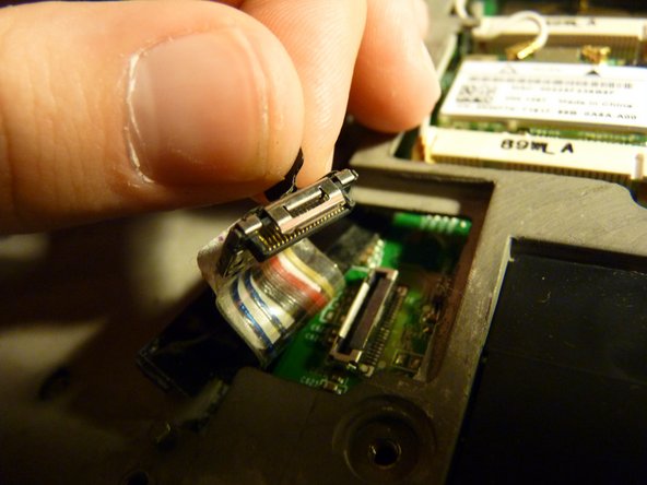

  • If you found it difficult to remove the drive or the cable connecting the drive to the motherboard, you can remove the whole cable at once
  • If you look to the right of the drive, you will see another tab, this one is black, but I've also seen blue ones
  • Pull this tab gently in order to remove the cable
  • Again, wiggling also helps
