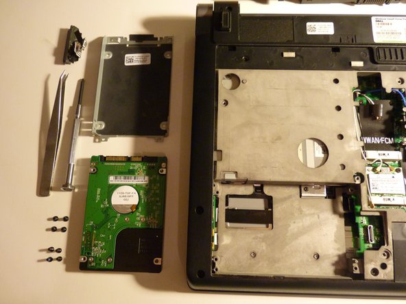

  • If you removed the drive using steps 1-7 then what you have should be left in picture 1
  • If you had trouble removing the drive, and you went through to step 8, then the parts remaining will be in picture 2
  • The drive should have a SATA interface, so you should be able to mount it into another computer using 2.5" to 3.5" converter brackets and a SATA cable
