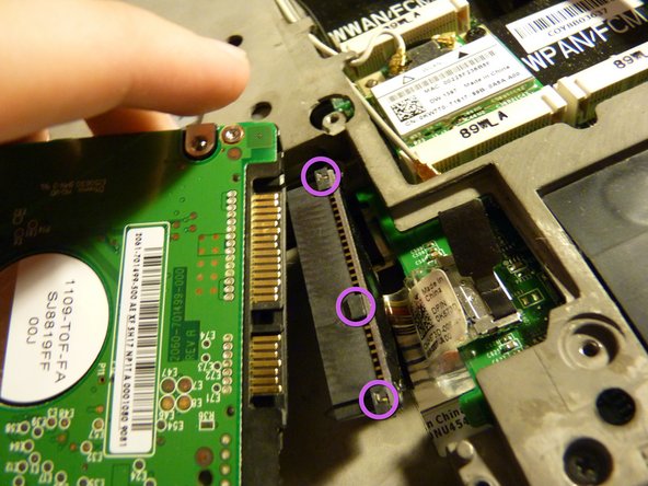

  • Now that the drive is removed, we have to remove the cable connecting it to the motherboard
  • It may be hard to do at first, but there are some groves that you can use to hold on to
  • Pull the connector from the drive gently
  • Wiggling the connector a bit does help a little
