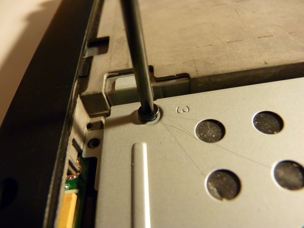

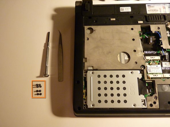

  • Now we remove the screws holding the drive to the caddy
  • These screws are have a flatter head, and are shorter
  • These are standard drive screws that are used to mount any hard drive to a mounting device, such as brackets to put it in a desktop computer
  • The manufacturer likes to put these in very tightly, and it may take some effort to remove. I suggest using a screwdriver with a bigger handle, not the one I am using
  • Set these screws aside, apart from the screws we removed in the last step
