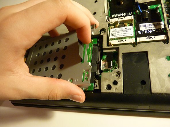

  • Now that the screws are removed, the caddy can be removed from the chassis and drive
  • Pull the black tab on the right side of the caddy, and pull up
  • It might take some wiggling but it should come out
