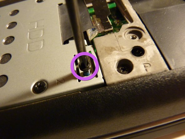

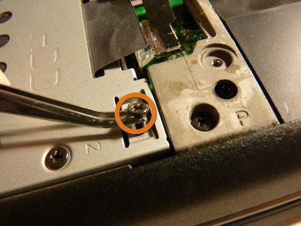

  • Now we have access to the internals of the laptop, pretty neat
  • If the battery is away from you, the hard drive should be closer towards you on the left
  • Start by removing the screws holding the caddy into the chassis
  • These screws have a more rounded top, and are longer
  • Once loosened, you can remove with your fingers or tweezers, and then set them aside
