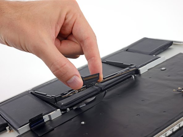

Grab the battery connector or the top edge of the plastic battery frame and lift it slightly, exposing the top edge of the two center battery cells. Grab the battery connector or the top edge of the plastic battery frame and lift it slightly, exposing the top edge of the two center battery cells.
  • Grab the battery connector or the top edge of the plastic battery frame and lift it slightly, exposing the top edge of the two center battery cells.
Pak de batterijaansluiting of de bovenkant van het plasticen batterijframe vast en til deze lichtjes omhoog, zodat je bovenkant van de twee middelste batterijcellen zichtbaar wordt.
