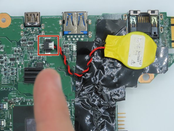

  • Use a nylon spudger to slightly push against the white bundled cable connector while evenly pulling the cable from the other side.
  • Remove the CMOS battery from the motherboard.
