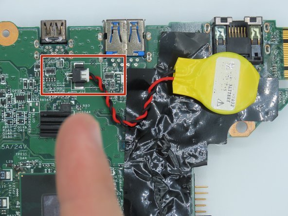

  • Flip the motherboard over and disconnect the CMOS battery from the motherboard by pulling the cable away from the connector.
  • It is important to note that the cable must be pulled evenly away from the connector to prevent damage to the connector or cable.
