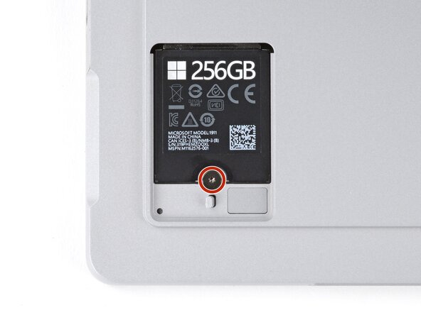

    1. Microsoft Surface Pro 7+ Screen Replacement, Remove the SSD screw: stap 4, afbeelding 1 van 2 Microsoft Surface Pro 7+ Screen Replacement, Remove the SSD screw: stap 4, afbeelding 2 van 2
      • Removing the SSD also functions as a battery disconnect and should be done before all major repairs.
      • Use a Torx Plus 3IP screwdriver to remove the 2.2 mm‑long screw securing the SSD.

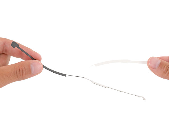

    4. Microsoft Surface Pro 7+ Screen Replacement, Adhesive information: stap 9, afbeelding 1 van 3 Microsoft Surface Pro 7+ Screen Replacement, Adhesive information: stap 9, afbeelding 2 van 3 Microsoft Surface Pro 7+ Screen Replacement, Adhesive information: stap 9, afbeelding 3 van 3
      • Don't insert your pick more than 8 mm when separating the screen adhesive. Otherwise, you may damage your device's internals.
      • When separating the top edge adhesive, follow instructions carefully to avoid damaging the front camera.
      • To prevent inserting your pick too far, measure 8 mm from the tip and mark the opening pick with a permanent marker.
      • Alternatively, tape a coin to a pick 8 mm from the tip.
      • If you're having trouble separating the adhesive, use the third photo as a reference for the adhesive location.

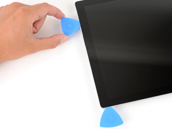

    5. Microsoft Surface Pro 7+ Screen Replacement, Insert an opening pick: stap 10, afbeelding 1 van 3 Microsoft Surface Pro 7+ Screen Replacement, Insert an opening pick: stap 10, afbeelding 2 van 3 Microsoft Surface Pro 7+ Screen Replacement, Insert an opening pick: stap 10, afbeelding 3 van 3
      • Insert the tip of an opening pick under the screen near the bottom of the right speaker cutout.
      • Be careful not to damage the speaker mesh, or you'll need to replace it.
      • Slide your pick towards the bottom edge so the tip goes under the notch in the screen.
      Vraag FixBot
      Voeg opmerking toe
    6. Microsoft Surface Pro 7+ Screen Replacement, Separate the right edge adhesive: stap 11, afbeelding 1 van 3 Microsoft Surface Pro 7+ Screen Replacement, Separate the right edge adhesive: stap 11, afbeelding 2 van 3 Microsoft Surface Pro 7+ Screen Replacement, Separate the right edge adhesive: stap 11, afbeelding 3 van 3
      • Remember not to insert your pick more than 8 mm.
      • Slide the pick down the right edge to separate the adhesive securing it.
      • Leave the pick inserted under the bottom right corner to prevent the adhesive from re‑sealing.

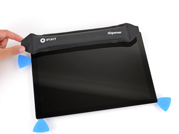

    7. Microsoft Surface Pro 7+ Screen Replacement, Heat the bottom edge: stap 12, afbeelding 1 van 1
      • Heat the bottom edge of the screen with an iOpener, hair dryer, or heat gun.
      Vraag FixBot
      Voeg opmerking toe

    9. Microsoft Surface Pro 7+ Screen Replacement, Heat the left edge: stap 14, afbeelding 1 van 1
      • Heat the left edge of the screen with an iOpener, hair dryer, or heat gun.
      Vraag FixBot
      Voeg opmerking toe

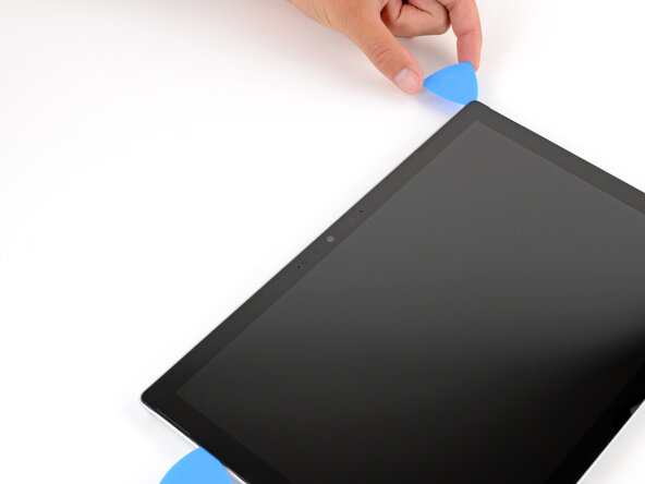

    11. Microsoft Surface Pro 7+ Screen Replacement, Heat the top edge: stap 16, afbeelding 1 van 1
      • Heat the top edge of the screen with an iOpener, hair dryer, or heat gun.
      Vraag FixBot
      Voeg opmerking toe
    12. Microsoft Surface Pro 7+ Screen Replacement, Insert an opening pick: stap 17, afbeelding 1 van 3 Microsoft Surface Pro 7+ Screen Replacement, Insert an opening pick: stap 17, afbeelding 2 van 3 Microsoft Surface Pro 7+ Screen Replacement, Insert an opening pick: stap 17, afbeelding 3 van 3
      • Insert a fourth pick under the screen near the top of the left speaker cutout.
      • Slide your pick towards the top edge so the tip goes under the notch in the screen.
      Vraag FixBot
      Voeg opmerking toe
    13. Microsoft Surface Pro 7+ Screen Replacement, Separate the top edge adhesive: stap 18, afbeelding 1 van 3 Microsoft Surface Pro 7+ Screen Replacement, Separate the top edge adhesive: stap 18, afbeelding 2 van 3 Microsoft Surface Pro 7+ Screen Replacement, Separate the top edge adhesive: stap 18, afbeelding 3 van 3
      • Don't slide the pick over the front facing camera. Remove the pick enough that it can slide past the camera without touching it.
      • Slide the pick along the top edge to separate the adhesive.
      • You'll likely need to slide the pick around the perimeter a second time to fully separate all the screen adhesive.

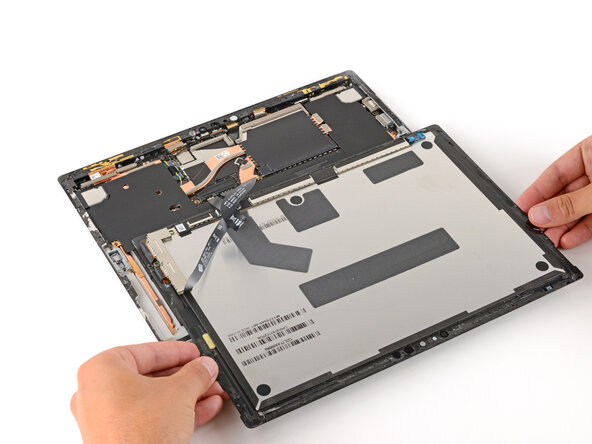

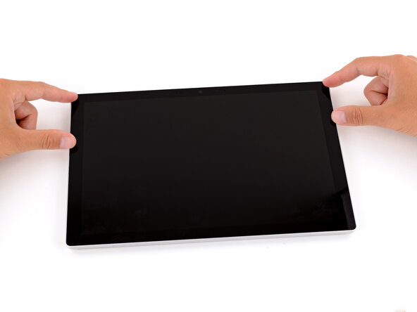

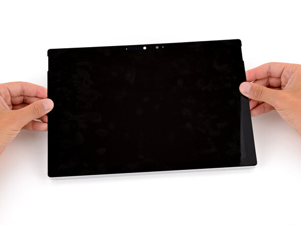

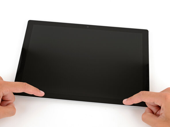

    14. Microsoft Surface Pro 7+ Screen Replacement, Flip the screen over: stap 19, afbeelding 1 van 3 Microsoft Surface Pro 7+ Screen Replacement, Flip the screen over: stap 19, afbeelding 2 van 3 Microsoft Surface Pro 7+ Screen Replacement, Flip the screen over: stap 19, afbeelding 3 van 3
      • Once the screen is fully separated, slightly lift the top edge and flip the screen so it can lay flat.
      • Be careful not to strain the screen cables.

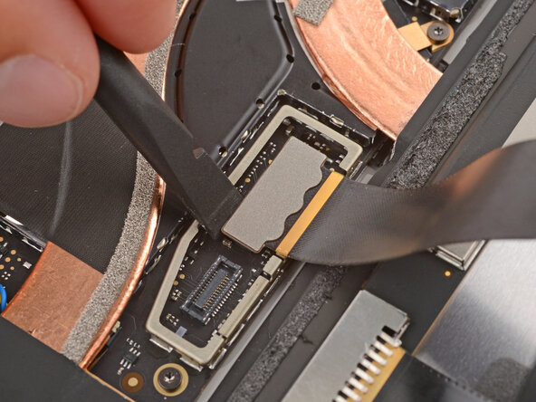

    15. Microsoft Surface Pro 7+ Screen Replacement, Remove the screen cable cover: stap 20, afbeelding 1 van 3 Microsoft Surface Pro 7+ Screen Replacement, Remove the screen cable cover: stap 20, afbeelding 2 van 3 Microsoft Surface Pro 7+ Screen Replacement, Remove the screen cable cover: stap 20, afbeelding 3 van 3
      • Use the flat end of a spudger to gently lift the edges of the metal screen cable cover to unclip it.
      • Be careful not to deform the cover too much, as you'll need to reinstall it during reassembly.
      • Remove the cable cover.

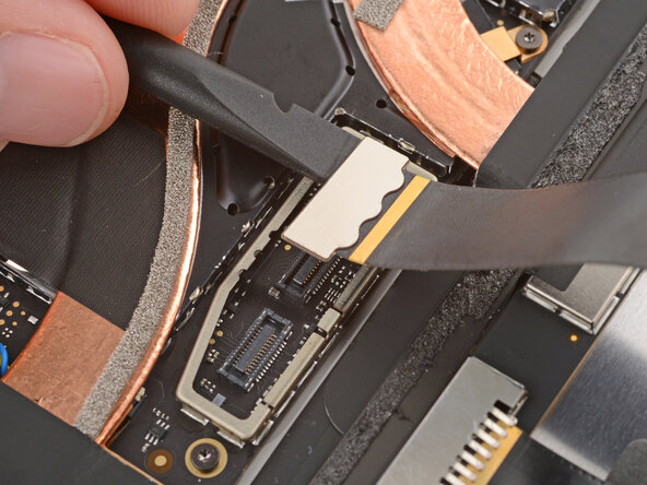

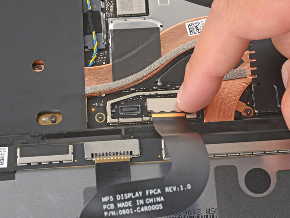

    16. Microsoft Surface Pro 7+ Screen Replacement, Disconnect the screen cables: stap 21, afbeelding 1 van 2 Microsoft Surface Pro 7+ Screen Replacement, Disconnect the screen cables: stap 21, afbeelding 2 van 2
      • Use a spudger to pry up and disconnect the smaller screen cable press connector.
      Vraag FixBot
      Voeg opmerking toe

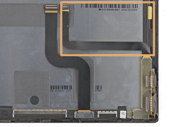

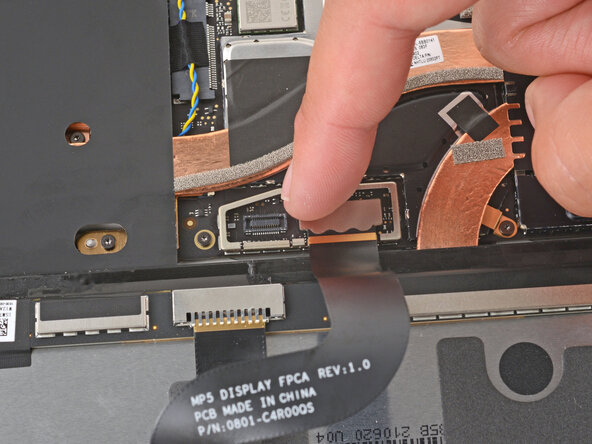

    17. Microsoft Surface Pro 7+ Screen Replacement: stap 22, afbeelding 1 van 3 Microsoft Surface Pro 7+ Screen Replacement: stap 22, afbeelding 2 van 3 Microsoft Surface Pro 7+ Screen Replacement: stap 22, afbeelding 3 van 3
      • Use a spudger to pry up and disconnect the wide screen cable press connector, starting on one of the short sides and moving to the other.
      Vraag FixBot
      Voeg opmerking toe

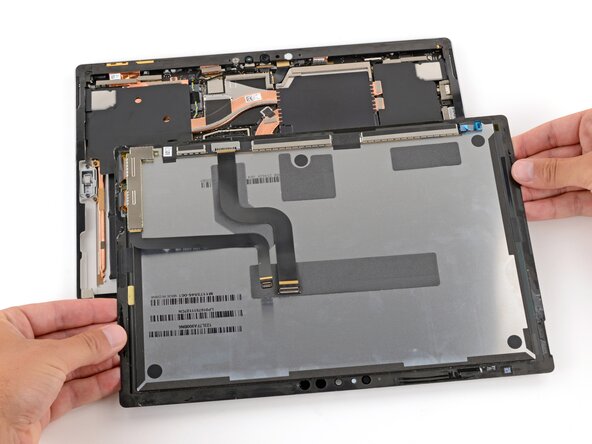

    18. Microsoft Surface Pro 7+ Screen Replacement, Remove the screen: stap 23, afbeelding 1 van 1
      • Remove the screen.

    1. Microsoft Surface Pro 7+ Screen Replacement, Transfer screen parts: stap 24, afbeelding 1 van 3 Microsoft Surface Pro 7+ Screen Replacement, Transfer screen parts: stap 24, afbeelding 2 van 3 Microsoft Surface Pro 7+ Screen Replacement, Transfer screen parts: stap 24, afbeelding 3 van 3
      • Compare your replacement screen to the original. You may need to transfer the following parts:
      • The skinny board located near the bottom right of the screen.
      • Two S shaped screen cables attached to the original screen.
      • If your replacement screen comes with these parts installed, you can skip down to the adhesive removal step.

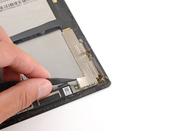

    2. Microsoft Surface Pro 7+ Screen Replacement, Remove the screen cable cover: stap 25, afbeelding 1 van 3 Microsoft Surface Pro 7+ Screen Replacement, Remove the screen cable cover: stap 25, afbeelding 2 van 3 Microsoft Surface Pro 7+ Screen Replacement, Remove the screen cable cover: stap 25, afbeelding 3 van 3
      • Use the point of a spudger to pry up and unclip the screen cable's metal cover.
      • Remove the cover.

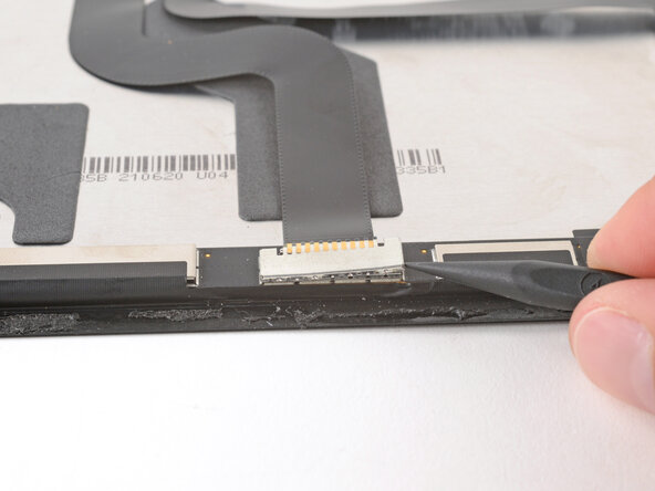

    3. Microsoft Surface Pro 7+ Screen Replacement, Disconnect the screen cable: stap 26, afbeelding 1 van 3 Microsoft Surface Pro 7+ Screen Replacement, Disconnect the screen cable: stap 26, afbeelding 2 van 3 Microsoft Surface Pro 7+ Screen Replacement, Disconnect the screen cable: stap 26, afbeelding 3 van 3
      • Use a spudger to pry up and disconnect the screen cable press connector, starting on one of the short sides and moving to the other.
      Vraag FixBot

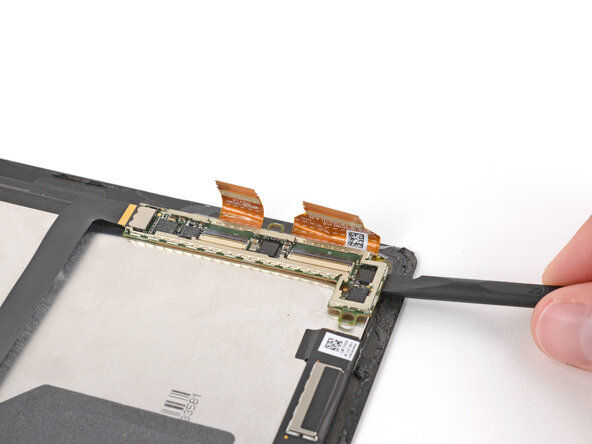

    5. Microsoft Surface Pro 7+ Screen Replacement, Remove the board cover: stap 28, afbeelding 1 van 3 Microsoft Surface Pro 7+ Screen Replacement, Remove the board cover: stap 28, afbeelding 2 van 3 Microsoft Surface Pro 7+ Screen Replacement, Remove the board cover: stap 28, afbeelding 3 van 3
      • Use the point of a spudger to pry up and unclip the edges of the metal cover on the board (near the bottom right of the screen).
      • Remove the cover.

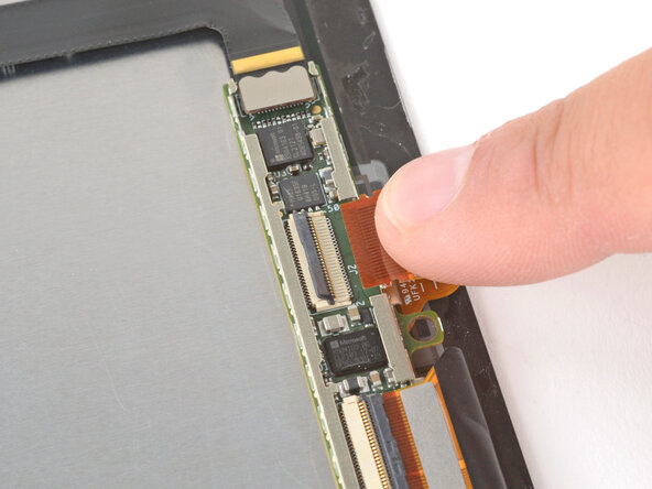

    6. Microsoft Surface Pro 7+ Screen Replacement, Disconnect the board: stap 29, afbeelding 1 van 3 Microsoft Surface Pro 7+ Screen Replacement, Disconnect the board: stap 29, afbeelding 2 van 3 Microsoft Surface Pro 7+ Screen Replacement, Disconnect the board: stap 29, afbeelding 3 van 3
      • Use the flat end of a spudger to lift the hinged, locking flaps on the board's two ZIF connectors.
      Vraag FixBot
      Voeg opmerking toe

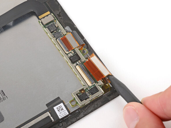

    7. Microsoft Surface Pro 7+ Screen Replacement: stap 30, afbeelding 1 van 3 Microsoft Surface Pro 7+ Screen Replacement: stap 30, afbeelding 2 van 3 Microsoft Surface Pro 7+ Screen Replacement: stap 30, afbeelding 3 van 3
      • Use the point of a spudger to slide both cables completely out of their sockets.
      • You can leave the ribbon cable connected to the top edge of the board, since you're going to be transferring it.

    8. Microsoft Surface Pro 7+ Screen Replacement, Remove the board: stap 31, afbeelding 1 van 3 Microsoft Surface Pro 7+ Screen Replacement, Remove the board: stap 31, afbeelding 2 van 3 Microsoft Surface Pro 7+ Screen Replacement, Remove the board: stap 31, afbeelding 3 van 3
      • Mild adhesive secures the board to the screen.
      • Slide the flat end of a spudger under the board and lift to remove it.

    5. Microsoft Surface Pro 7+ Screen Replacement, Reconnect the cable: stap 37, afbeelding 1 van 1
      • Lay the screen cable in place so the bend lines up with the other screen cable.
      • If the cable is positioned the wrong way, you won't be able to reconnect the screen.
      Vraag FixBot
      Voeg opmerking toe
    6. Microsoft Surface Pro 7+ Screen Replacement: stap 38, afbeelding 1 van 3 Microsoft Surface Pro 7+ Screen Replacement: stap 38, afbeelding 2 van 3 Microsoft Surface Pro 7+ Screen Replacement: stap 38, afbeelding 3 van 3
      • Use your finger to press down and reconnect the screen cable press connector, starting on one side and moving to the other.
      Vraag FixBot
      Voeg opmerking toe
    7. Microsoft Surface Pro 7+ Screen Replacement, Install the cable cover: stap 39, afbeelding 1 van 2 Microsoft Surface Pro 7+ Screen Replacement, Install the cable cover: stap 39, afbeelding 2 van 2
      • Set the cable's metal cover in place and press down around the perimeter to secure it.
      Vraag FixBot

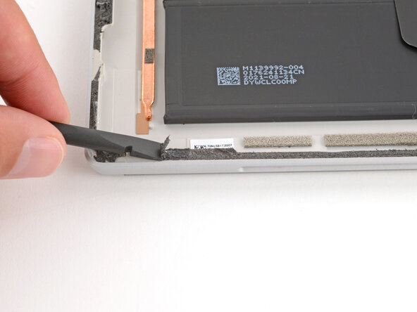

    1. Microsoft Surface Pro 7+ Screen Replacement, Remove the old screen adhesive: stap 40, afbeelding 1 van 3 Microsoft Surface Pro 7+ Screen Replacement, Remove the old screen adhesive: stap 40, afbeelding 2 van 3 Microsoft Surface Pro 7+ Screen Replacement, Remove the old screen adhesive: stap 40, afbeelding 3 van 3
      • Use a spudger and your fingers (or tweezers) to scrape up and remove all the old screen adhesive from the perimeter of the frame.
      • If you're reusing your screen, repeat the process to remove any of the old screen adhesive from it.
      • To prevent damaging your screen, press gently with the spudger and make sure nothing is under the screen while you work.

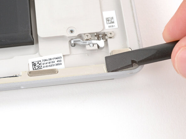

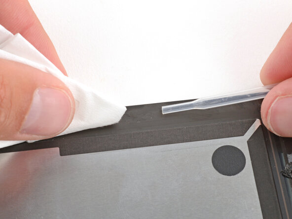

    2. Microsoft Surface Pro 7+ Screen Replacement: stap 41, afbeelding 1 van 3 Microsoft Surface Pro 7+ Screen Replacement: stap 41, afbeelding 2 van 3 Microsoft Surface Pro 7+ Screen Replacement: stap 41, afbeelding 3 van 3
      • Take your time and be very thorough during the next two steps. A clean frame allows replacement adhesive to lay evenly, ensuring a better bond.
      • The old adhesive likely left behind a thin, clear film on the frame. Use a spudger and tweezers to peel any traces of the film from the frame.
      • If you're reusing your screen, repeat the process to remove any of the adhesive film left on the screen.

    3. Microsoft Surface Pro 7+ Screen Replacement, Clean the frame: stap 42, afbeelding 1 van 2 Microsoft Surface Pro 7+ Screen Replacement, Clean the frame: stap 42, afbeelding 2 van 2
      • Use a lint‑free cloth (or coffee filter) and some high‑concentration (>90%) isopropyl alcohol to thoroughly clean the frame where you removed the old screen adhesive.
      • If you're reusing the screen, repeat the process to clean its perimeter.

    4. Microsoft Surface Pro 7+ Screen Replacement, Adhesive strips information: stap 43, afbeelding 1 van 1
      • Before applying any screen adhesives, find their proper orientation on the frame. Use cutouts and notches in the adhesive to match each strip to its spot on the perimeter.
      • The top strip has lots of circular cutouts for the cameras and sensors.

      • Lay the screen display-side-down on the device so you can reconnect the two cables.
      • The screen should be oriented so when you flip it over, the top edge of the screen is lined up with the top edge of the frame.

    10. Microsoft Surface Pro 7+ Screen Replacement, Connect the screen: stap 49, afbeelding 1 van 3 Microsoft Surface Pro 7+ Screen Replacement, Connect the screen: stap 49, afbeelding 2 van 3 Microsoft Surface Pro 7+ Screen Replacement, Connect the screen: stap 49, afbeelding 3 van 3
      • Use your finger to press down and reconnect both of the screen cable press connectors.
      • For the larger connector, press first on one short side, then the other, until it clicks into place.

    15. Microsoft Surface Pro 7+ Screen Replacement: stap 54, afbeelding 1 van 3 Microsoft Surface Pro 7+ Screen Replacement: stap 54, afbeelding 2 van 3 Microsoft Surface Pro 7+ Screen Replacement: stap 54, afbeelding 3 van 3
      • Use your fingers to press down on the entire perimeter of the screen to secure it in the frame.
      • Check the edges of the screen and make sure they're sitting flush in the frame—there should be no gaps.

    18. Microsoft Surface Pro 7+ Screen Replacement: stap 57, afbeelding 1 van 2 Microsoft Surface Pro 7+ Screen Replacement: stap 57, afbeelding 2 van 2
      • Use a Torx Plus 3IP screwdriver to install the 2.2 mm‑long SSD screw.
