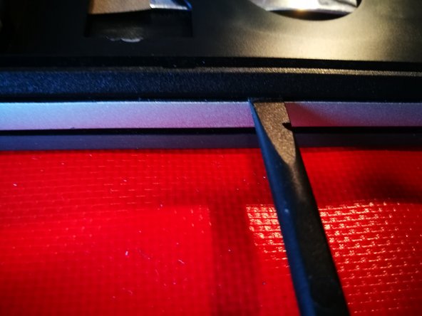

Opening case
  • This step is for the bottom side of the laptop (where HDD and memory are). Using an opening pick, to not damage the case.
  • Starting in an edge, pull the pick in. Slide left-right/right-left, to create an opening.
  • No problem when you hear a click-sound.
  • When there is an opening, use a spudger to seperate the rest of the downside of the case. Slide it trough the whole downside.
  • Slide further with the spudger to the side where are the least ports (one USB port). Optionally use a opening pick, if necessary.
