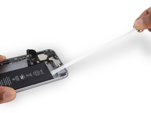

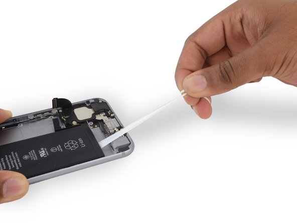

  • Try not to wrinkle the strips during this procedure—they will become very difficult to deal with and will not straighten out again.
  • Pull one of the adhesive strips straight out, towards the bottom of the iPhone.
  • For best results, pull the strip at a 60º angle or less.
  • The strip will stretch to many times its original length. Continue to pull steadily, re-grabbing the strip closer to the iPhone if necessary.
  • Continue pulling until the strip is fully removed.
  • If the battery adhesive tabs break off at any point during the removal process, use your fingers or blunt tweezers to retrieve the remaining length of adhesive, and continue pulling.
  • If one of the adhesive strips breaks under the battery during this procedure, and cannot be retrieved, remove the remaining strip, and then skip to Step 48.
