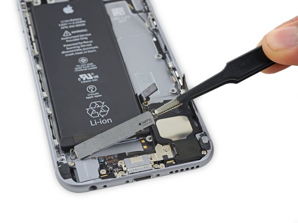

  • Remove the two 1.5 mm Phillips screws holding the Taptic Engine in place.
  • Remove the Taptic Engine.
