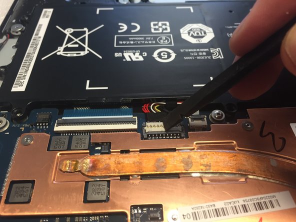

Replacing the Battery
  • Put the new battery over the holding posts and gently put the cable onto the connecter. Gently push on one side at a time as there are two clasps that keep the cable connected. You will hear two clicks when the cable is seated correctly.
  • Take the flat part of your spudger and carefully verify the cable is fully seated.
  • Once the cable is seated, put the four screws back in. This will secure the battery.
  • Put the screws in loosely until all four are in place before tightening them down.
