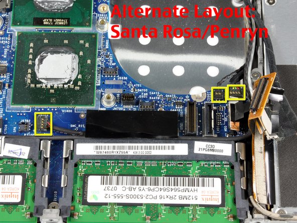

  • Use a spudger to disconnect the speaker connector and bluetooth connector from the logic board.
  • If you have a MacBook Core 2 Duo Santa Rosa/Penryn, disconnect the PRAM battery cable.
