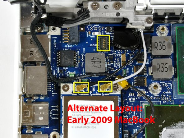

  • Disconnect the three antenna cables from the Airport card, and the black inverter cable from the logic board.
  • If you have a MacBook Core 2 Duo Santa Rosa/Penryn/Early 2009, there are only two antenna cables and the black inverter cable's connector is closer to the upper end of the Airport card.
