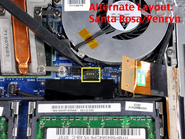

Use a spudger to disconnect the black fan connector from the logic board.
If you have a MacBook Core 2 Duo Santa Rosa/Penryn, the black fan connector resides in a different location.
