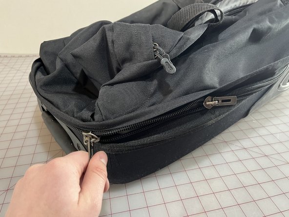

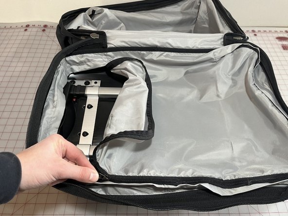

Test the handle functionality
  • Test that the handle works properly. Move the handle into all positions and ensure it locks securely at each position:
  • Fully extended
  • Middle position (medium and small bags only)
  • Fully collapsed into the handle housing
  • The toggle buttons should move freely when the handle release button is pressed.
  • If the toggles function but need some TLC, see Stuck Luggage Handle Lubrication.
  • Close the interior liner zipper and main zipper compartments.
测试拉杆是否正常工作。将拉杆移动至所有档位,并确保每个档位都能牢固锁定:
中间档位(仅限中号和小号行李箱)
完全收回至把手外壳内
当按下拉杆释放按钮时,伸缩卡舌应能灵活移动。
如果卡舌能工作但不够顺滑,请参考行李箱拉杆润滑处理
合上内衬拉链和主仓拉链。
