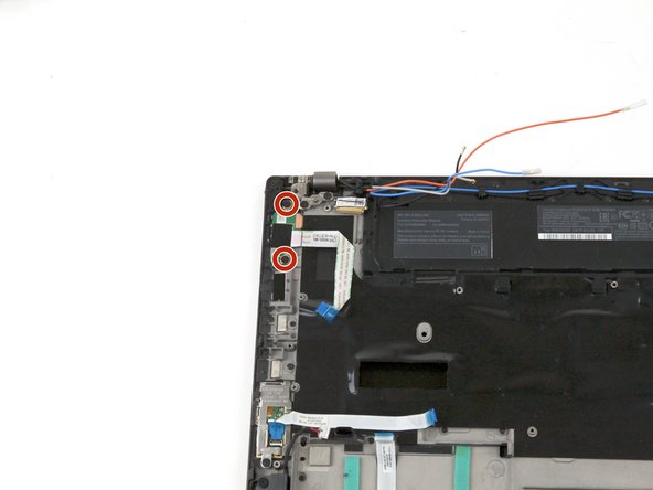

Lenovo ThinkPad T470 Power Button Board Replacement: stap 0, afbeelding 1 van 2 Lenovo ThinkPad T470 Power Button Board Replacement: stap 0, afbeelding 2 van 2
  • Use a Phillips #1 screwdriver to remove the two 4 mm screws from the power button board.
