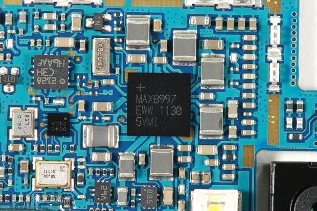

No Power Gets Hot
The Screen is cracked there are no signs of water and there is none of the sensors are triggered in the inside also the phone gets hot and there is no power and pc doesnt recognize it.

Rob Salamone, I would start by replacing the battery as well as the screen. It is possible that you have a damaged battery charging circuit and that is what heats up your phone. Check around the MAX8987 DC Power Management IC and see if you notice anything corroded or charred. Here is a teardown that will give you an idea how to get to the parts to be replaced. Attached image from here

here is what i found from the power management ic, should it need to be replaced??

Try the easy stuff first ;-) Battery and screen.....
door Deel
i tryed the battery it now works like a charm :) now i need to go drop $180 for that new screen :/
door Deel
So, are you saying it got resolved by replacing the battery :-)?
door Deel
yup it worked :)
