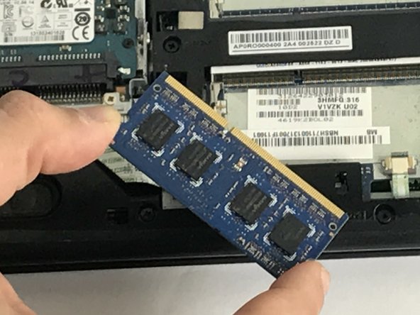

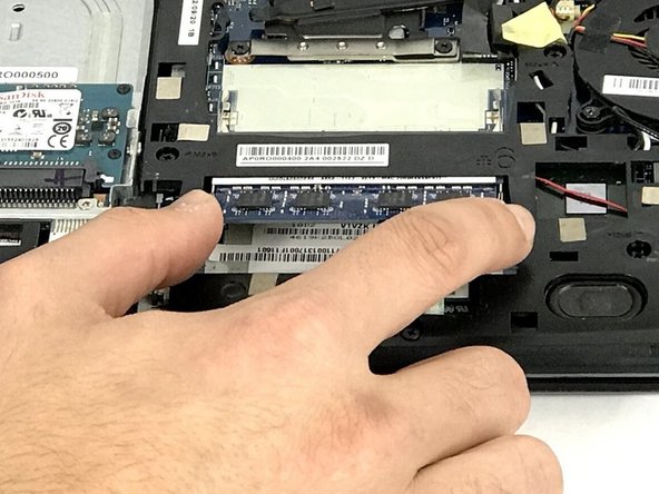

  • Locate the RAM module.
  • Squeeze the two metal clips on the sides of the RAM module to pop the RAM out.
  • Carefully remove from the slot.
  • When reassembling, stick RAM into slot and push down until a clicking sound is heard.
