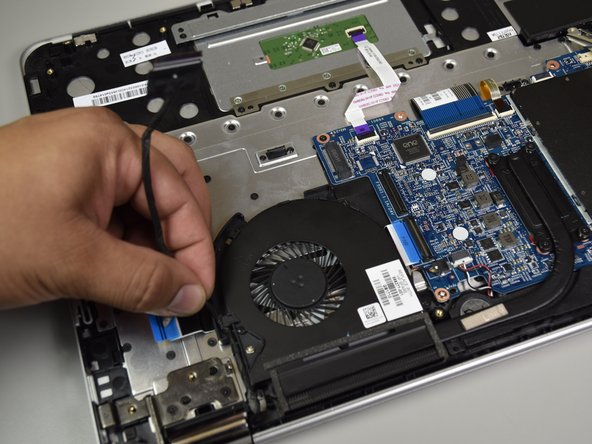

HP Envy x360 m6-aq103dx CPU Fan Replacement
Stap 3
HP Envy x360 m6-aq103dx CPU Fan Replacement: stap 0, afbeelding 1 van 2 HP Envy x360 m6-aq103dx CPU Fan Replacement: stap 0, afbeelding 2 van 2
  • Remove the black cable from the fan by unclicking it from the plastic body of the fan with your fingers and move it out of the area.
  • There will be clicking sounds when the black cable is removed.
