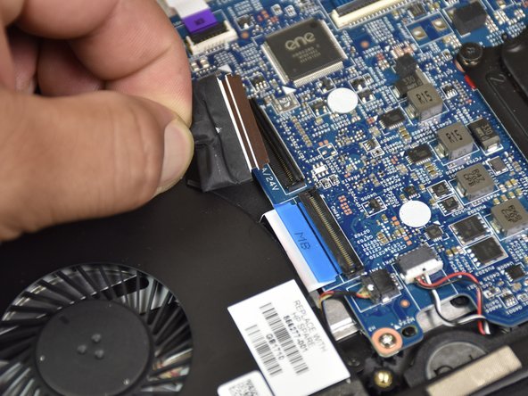

  • Put on the anti-static wristband first
  • Disconnect the port of the fan by flipping the black tab with the small blue plastic opening tool.
  • Remove the cable from the connector.
