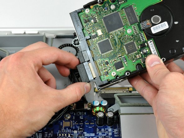

  • Insert the flat end of a spudger between the SATA power cable connector and the body of the hard drive.
  • Twist the spudger counter-clockwise to slightly separate the SATA power cable connector from its socket on the hard drive.
  • Pull the SATA power cable connector away from the hard drive.
