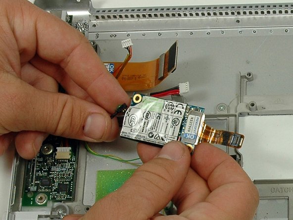

Stap 9
PowerBook G4 Aluminum 15" 1.67 GHz Lower Case Replacement: stap 0, afbeelding 1 van 2 PowerBook G4 Aluminum 15" 1.67 GHz Lower Case Replacement: stap 0, afbeelding 2 van 2
  • Remove the Phillips screws on the corners of the modem (two screws total).
  • Disconnect the modem from the cable on the left side and remove it from the computer.
