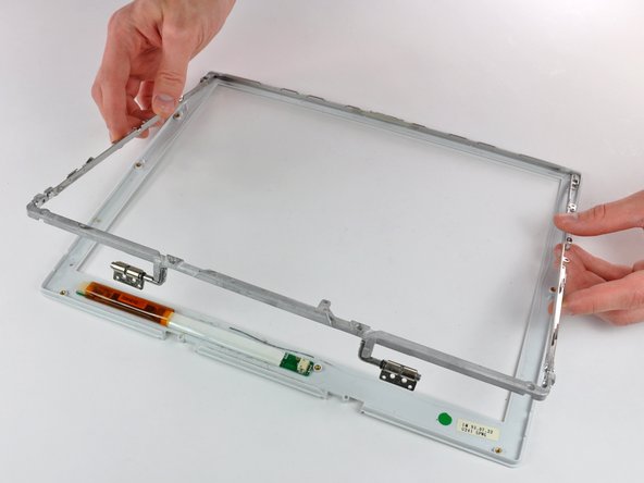

  • Remove the six Phillips screws securing the clutch hinges to the front display bezel.
  • Lift the clutch hinges off the front display bezel.
