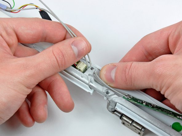

  • Remove the single Phillips screw securing the front bezel to the middle of the cast aluminum clutch hinge frame.
  • Carefully bend the front display bezel away from the clutch hinges as you slide the two AirPort antennas out from under the clutch hinge frame.
