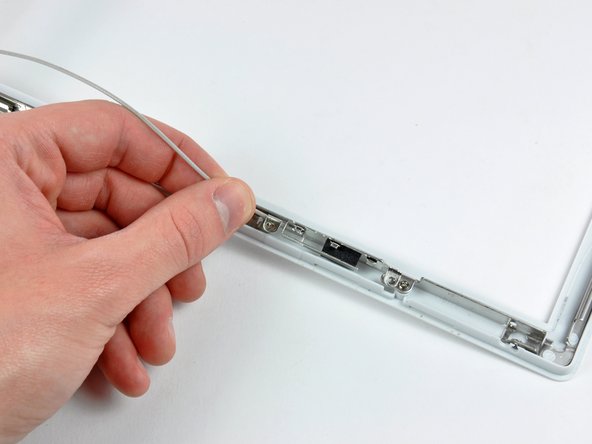

  • Remove the two Phillips screws securing the left AirPort antenna to the clutch hinge frame.
  • Carefully lift the left AirPort antenna off the clutch hinge frame.
