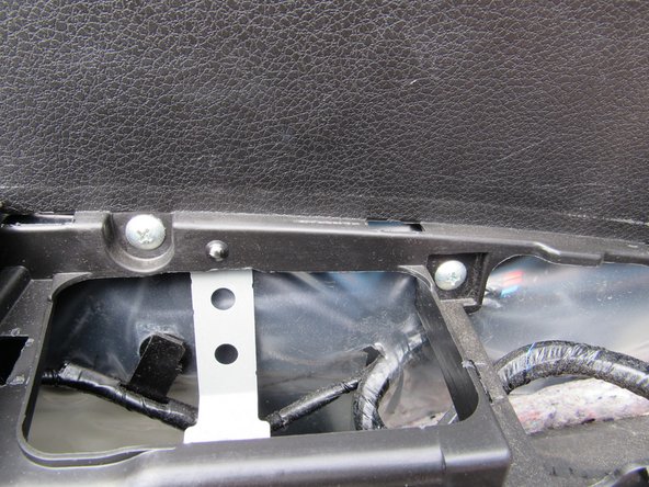

  • Using your flathead screwdriver, press the white tab on the side of the larger cord bundle connecting the assembly.
  • The larger cord bundle now can be pulled out.
  • Press the white tab on the smaller cord bundle and disconnect the smaller cord bundle from the assembly.
  • Take note of the two screws that are now visible in the middle of the door panel.
