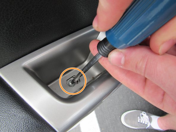

  • Use your Phillips screwdriver to unscrew the 8x3/4" Phillips screw by the upper door handle.
  • Unscrew the second 8x3/4" Phillips screw located inside the lower door handle on the door's armrest.
