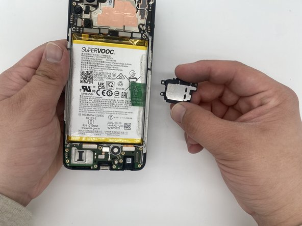

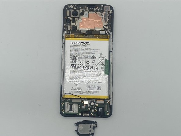

Stap 3
OnePlus Nord N20 5G Speaker Replacement: stap 0, afbeelding 1 van 3 OnePlus Nord N20 5G Speaker Replacement: stap 0, afbeelding 2 van 3 OnePlus Nord N20 5G Speaker Replacement: stap 0, afbeelding 3 van 3
  • Use a spudger to gently lift the speaker, disconnecting it from the motherboard.
  • Remove the speaker from the device.
