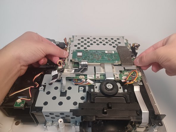

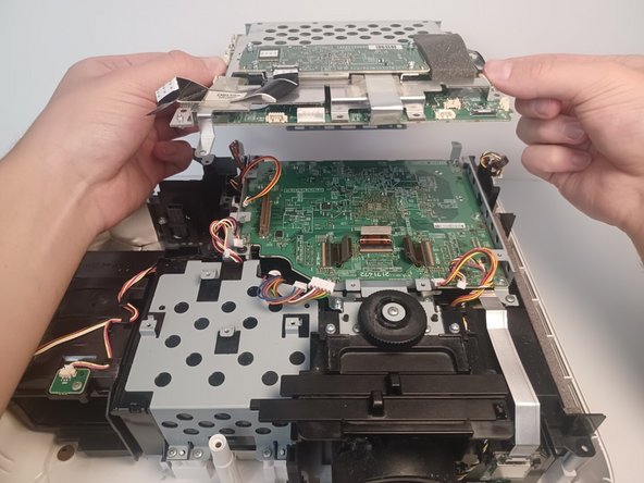

  • Remove twelve 5 mm Phillips #1 screws.
  • Using both hands, carefully lift the first half of the motherboard.
