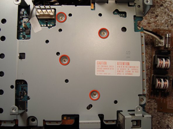

Stap 7
Sony PlayStation 2 Teardown: stap 0, afbeelding 1 van 3 Sony PlayStation 2 Teardown: stap 0, afbeelding 2 van 3 Sony PlayStation 2 Teardown: stap 0, afbeelding 3 van 3
  • Next we need to remove the plastic layer that protects the power supply so we can access to the screws beneath it.
  • Once all the screws are gone we can lift the metal frame by using a flathead screw and some leverage to unlock all four sides from the plastic case of the optical drive.
