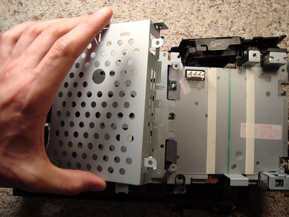

  • Here is what is left when the power supply is gone.
  • Now we can easily remove the protective case for the optional hdd.

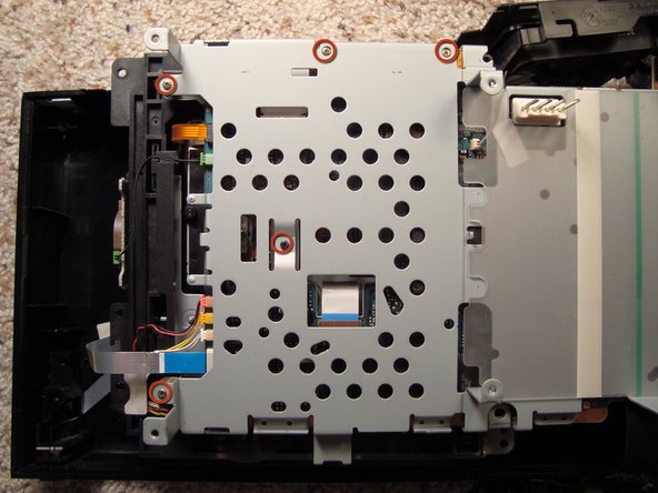

  • Done that we can unlock the optical drive from the metal frame.
