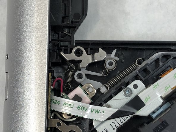

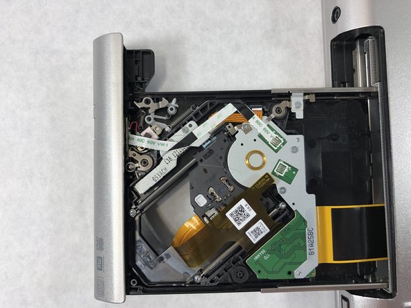

  • Remove the single 5mm Phillips #0 screw securing the latch mechanism to the disk drive.
  • Pull the damaged latch away from the disk drive and replace with the new latch.
