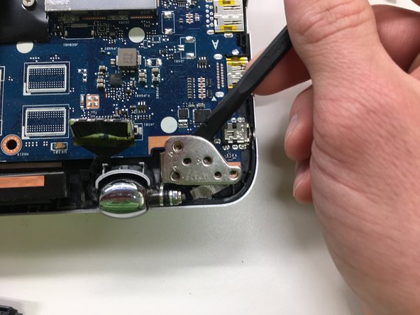

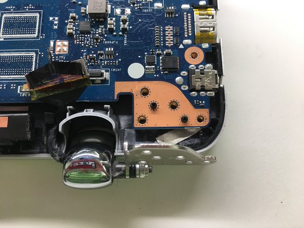

  • Remove the three Phillips screws securing the left hinge to the corner of the motherboard and lower case assembly.
  • Three 5.6 mm screws
  • Take a plastic pry tool and open the hinge about 75º-85º
  • You may have to open the laptop over the edge of a table and open the display in order to open the hinge.
