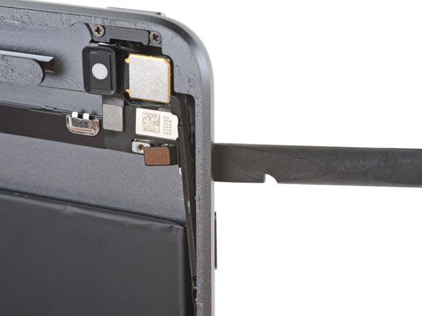

  20. iPad Air 3 Volume Button Cable Replacement, Disconnect the volume button cable: stap 20, afbeelding 1 van 2 iPad Air 3 Volume Button Cable Replacement, Disconnect the volume button cable: stap 20, afbeelding 2 van 2
    • Use the pointed end of a spudger to disconnect the volume button cable by lifting straight up on the press connector.

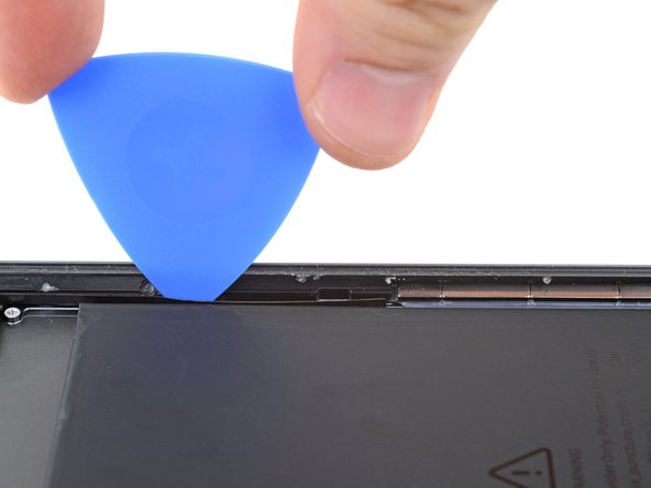

    • Insert an opening pick between the volume button cable and the rear case.
    • Slide it towards the rear camera to cut the adhesive securing the volume cable to the rear case.

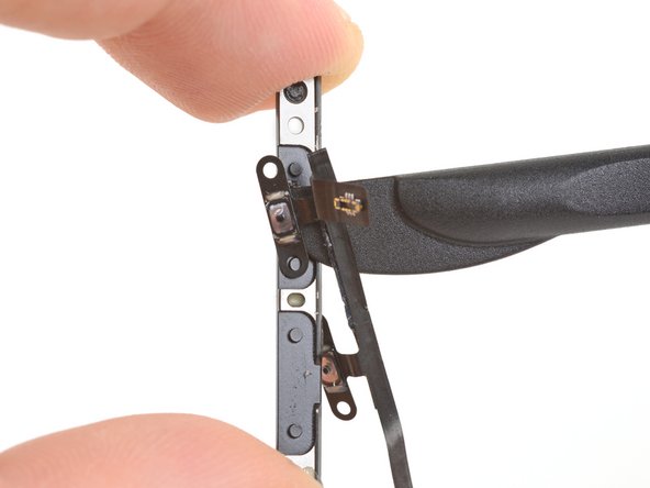

    • The next four steps show how to separate the volume button cable from the button bracket.
    • Use an opening pick or a halberd spudger to peel the volume button cable away from the bracket.

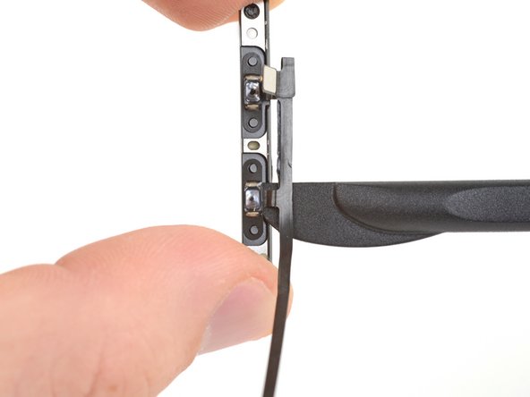

    • Insert an opening pick or a halberd spudger underneath the lower volume button to peel it away from the bracket.
  28. iPad Air 3 Volume Button Cable Replacement: stap 28, afbeelding 1 van 3 iPad Air 3 Volume Button Cable Replacement: stap 28, afbeelding 2 van 3 iPad Air 3 Volume Button Cable Replacement: stap 28, afbeelding 3 van 3

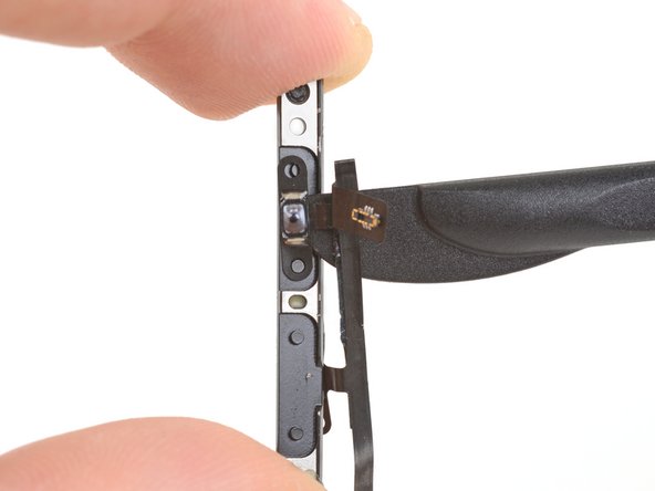

    • Insert an opening pick or a halberd spudger underneath the upper volume button to peel it away from the bracket.

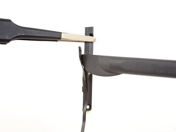

  29. iPad Air 3 Volume Button Cable Replacement: stap 29, afbeelding 1 van 1
    • Remove the volume button cable from the bracket.
