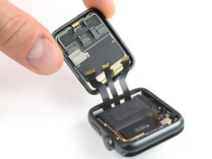

I am trying to replace the battery on an apple watch original. When I follow the directions here:
Apple Watch Vervanging van de batterij
I have 2 extra cables on the side opposite the crown and power button. I do not see those in the guide. What are they for? How do I get around them.

I figured it out. It was the haptic touch connectors
It is an SP1

It looks like you have a Series 2 or newer
Afbeelding
Here's the Series 2 guide for the battery replacement Apple Watch Series 2 Vervanging van de batterij which gets into the screen cables
