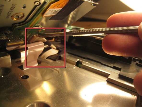

  • The screws holding in the drive were deep within the casing.
  • Once those screws were removed, the entire case could be lifted off.
  • Don't pull too hard! There are two cables attaching the drive to the logic board underneath.
  • This wire slid out from its horizontal slot. Once it was detached, the ribbon cable came out as well.
