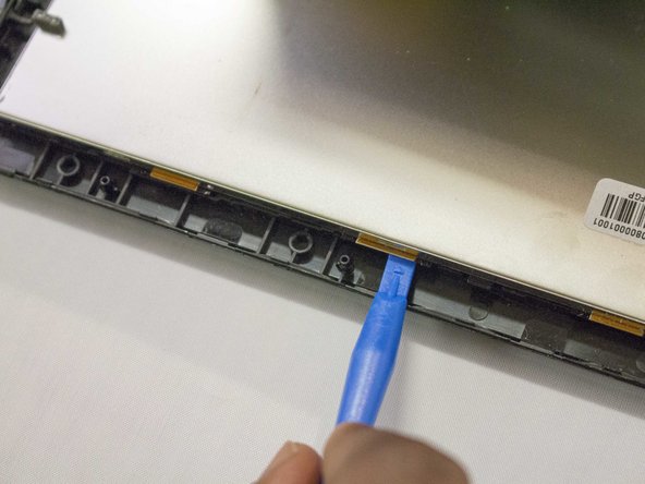

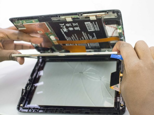

Separate the screen digitizer from the display screen, noting the placement of the quick disconnect ribbon cable.
Use a spudger if necessary to assist in the separation.
