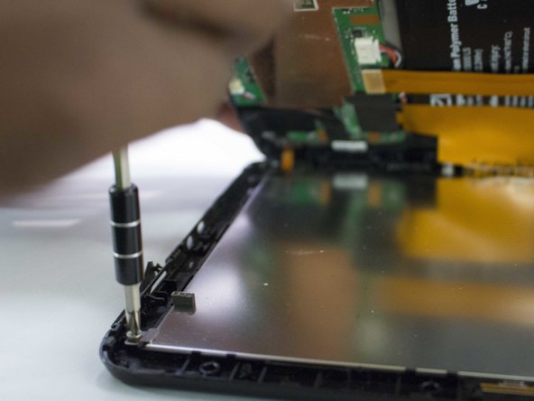

  • Remove the two screws present using the J1 Screw bit.
  • The screw has a head size of 4.3 mm and is 3 mm tall.
