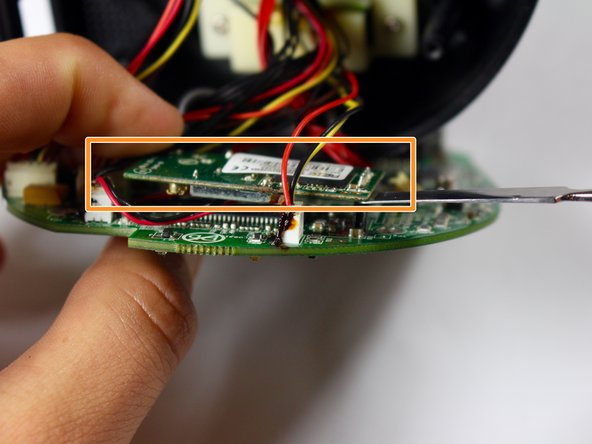

  • Remove the last two wired connections to the motherboard by severing the indicated connections.
  • Lift up the secondary motherboard as indicated using the metal spudger.
  • All connections should be severed from the motherboard and a new motherboard may be inserted.
  • It is advised to reapply adhesive to wired connections during reassembly.
