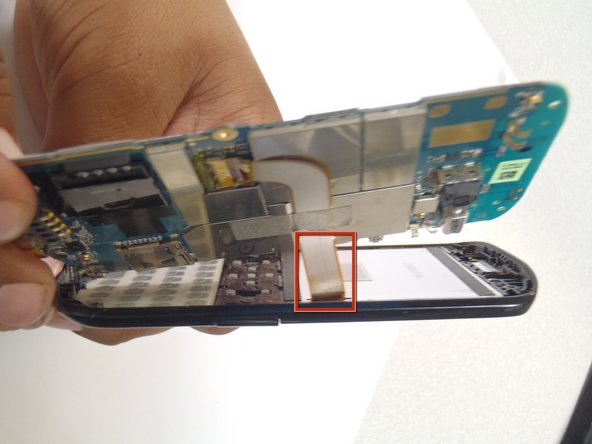

  • Pry the motherboard away from the front of the plastic case using a plastic opening tool.
  • Be careful not to break the ribbon cable when prying away the motherboard.
