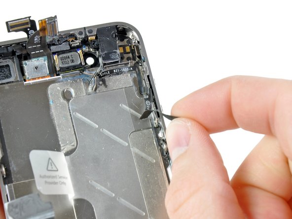

  • Use the edge of a plastic opening tool to peel the small strip of black tape off the back of the volume button bracket.
  • Peel the tape starting from the side nearest the top of the phone.
  • Carefully remove the remaining portion of tape off the small section of ribbon cable near the inside of the bottom volume button.
