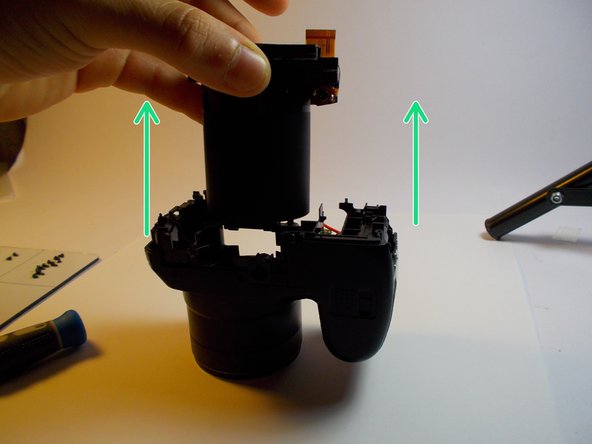

  • Remove the four larger silver plated screws placed on the inside of the lens.
  • Remove the lens by lifting it up from the cavity.
