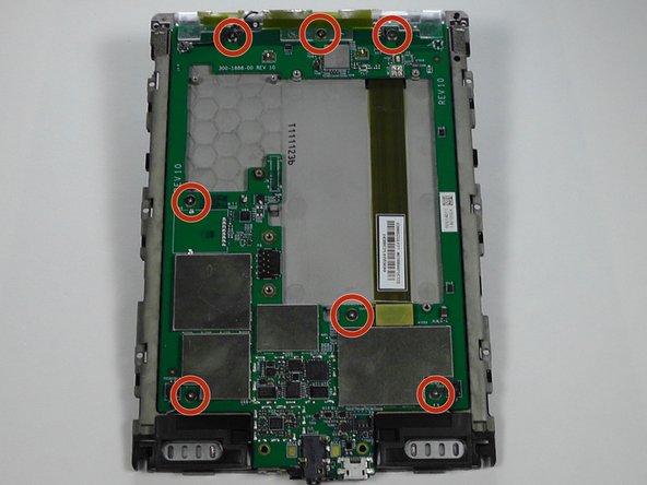

  • With the motherboard facing you, use the pointy end of your Spudger to gently separate the two speaker's connectors.
  • This connector type requires being lifted out of place, not pulled. Accidentally pulling may damage the wires.
  • During reassembly, make sure the speaker's connectors are not pushed behind the motherboard.
  • Use your #00 Phillips Screwdriver to remove the seven 2 mm screws.
