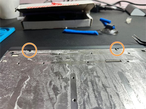

  • Very carefully slice through the adhesive in the pink box and undo the connector using the plastic prying tool, this is the connector to the battery.
  • You will be cutting close to a ribon cable so be very careful.
  • Start by removing the two silver screws in the orange boxes.
  • Slide the metal edge back before undoing the two black screws in the orange circles.
  • Remove the two silver screws in the blue circles.
  • Remove all the screws in the green circles.
