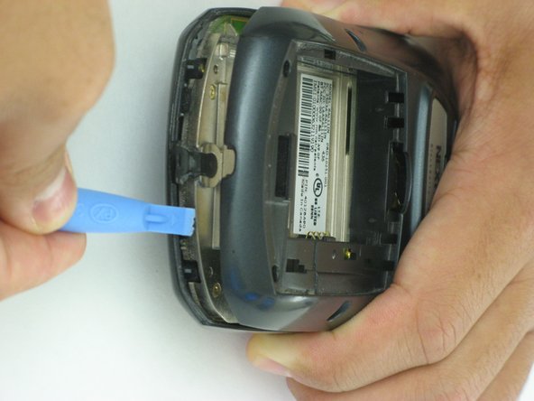

Use a pick or plastic iPod opening tool to push the clips, that are holding the rear casing. Apply a firm pressure at a forty-five degree angle to dislodge the clips.
Applying too much pressure could break the plastic clips and permanently damage the casing, so be careful.
