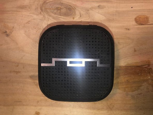

  • The rubber gasket has now been fully inverted and is only attached by the speaker grill to the front of the Punk housing

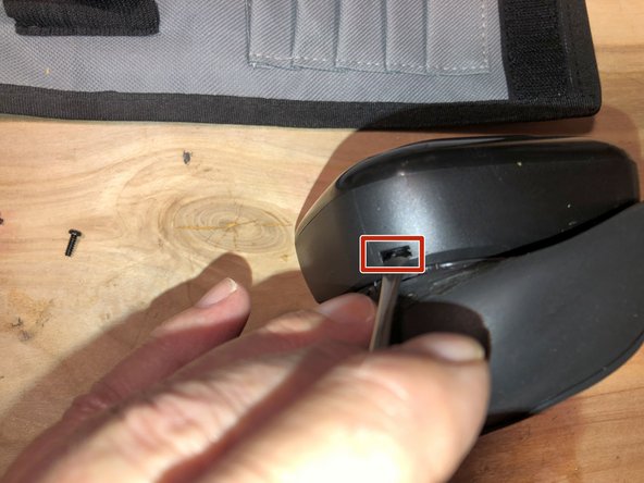

  • The speaker grill is attached via four (4) locking tabs in the housing. There are four relief openings. One on each corner of the housing.
  • Use a spudger or similar tool and insert it into the opening. A little inward push with the spudger will release the grill.
  • Once all four tabs have been released, the grill and rubber gasket will simply come off.
