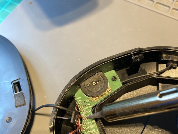

Turtle Beach Atlas One Audio Cable Replacement, De-solder the old wiring: stap 0, afbeelding 1 van 3 Turtle Beach Atlas One Audio Cable Replacement, De-solder the old wiring: stap 0, afbeelding 2 van 3 Turtle Beach Atlas One Audio Cable Replacement, De-solder the old wiring: stap 0, afbeelding 3 van 3
  • Desolder the top 3 connections. RIN+, LIN+, SPKR_IN
  • And the MIN_IN, and mic ground.
  • I removed the left headset too, so it is easier to work with the headset.
